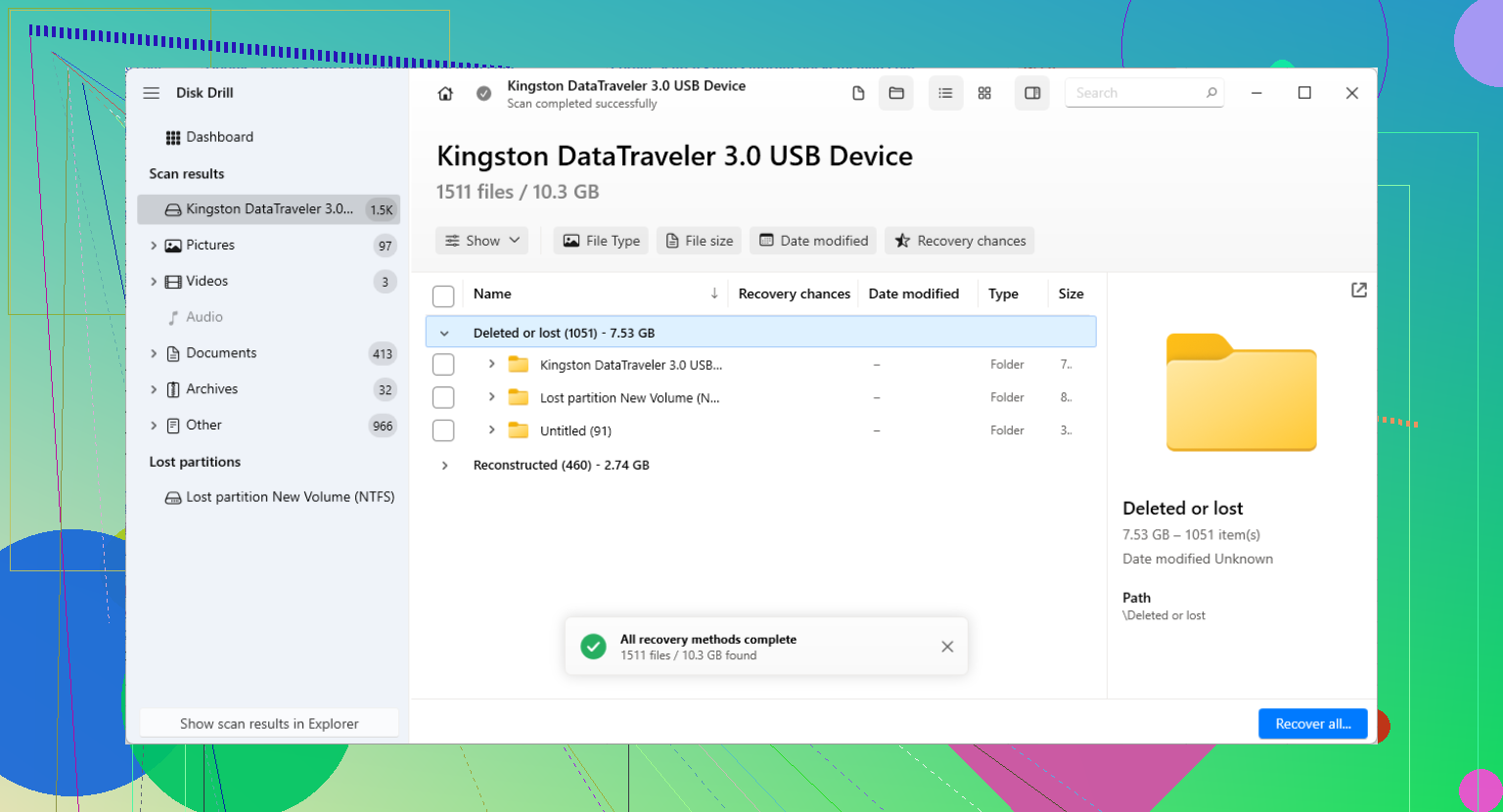

After that, focus on recovering the files before trying to repair the partition table. For a lot of people, that’s the safer order. Disk Drill is one option that’s easy enough to use and can look for lost partitions, damaged file systems, and file signatures without making you manually edit GPT data. The scan is non-destructive, so you can see what it finds before doing anything else.
If the scan shows your files and the previews look right, recover them to a different drive with enough space. Don’t save anything back onto the damaged disk. That can overwrite data you haven’t recovered yet.

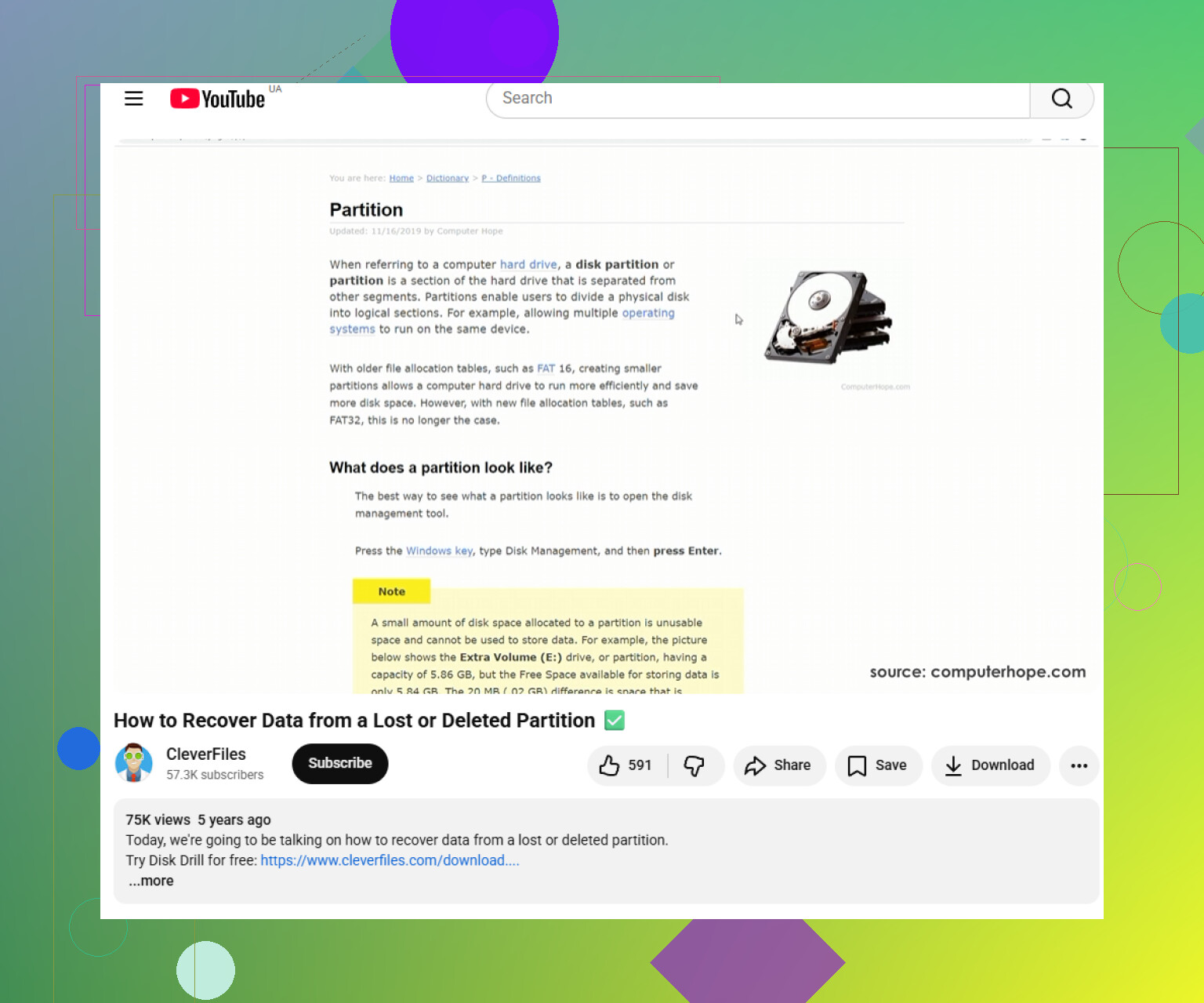

The easy mistake here is “repairing” the wrong drive and turning one bad clone into two bad disks. If you need a visual walkthrough, this lost GPT partition recovery guide is worth watching before touching anything.
