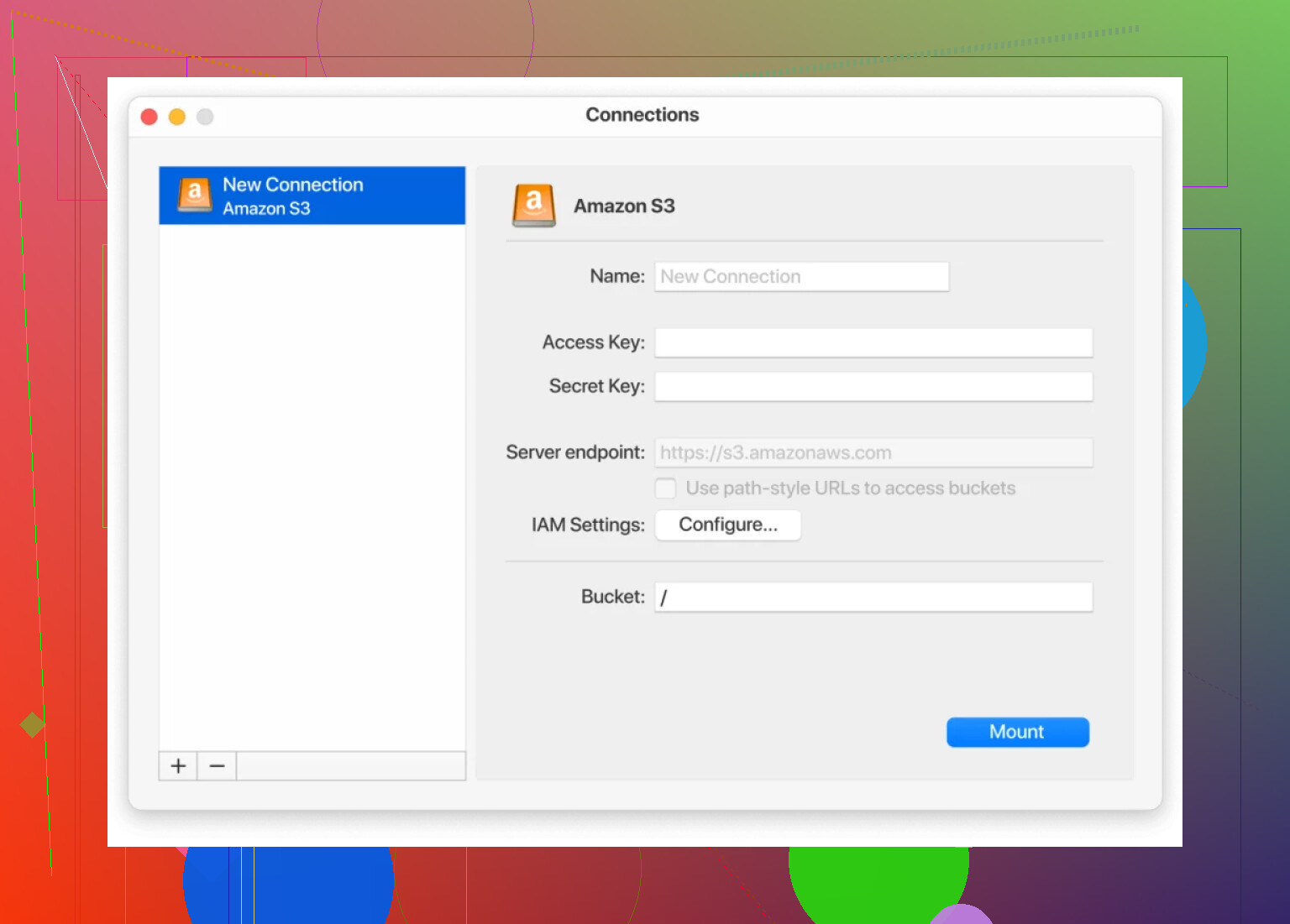

No-Code Crowd: Transfer with CloudMounter
Look, not everyone wants to stare at the terminal all day. Enter CloudMounter. It turns your S3 buckets into what looks like local drives. You’re basically dragging stuff around like it’s just files on your computer. Seriously, it feels like cheatin’ but it works.
Here’s the drill:
  1. Connect Both AWS Accounts. Plug your source and destination credentials in, all inside the CloudMounter app.
  2. Mount Your Buckets. Boom—each S3 bucket now sits alongside your regular drives in Finder (Mac) or File Explorer (Windows).
  3. Move Those Files. Literally drag from one bucket to the other. I like to toss on a progress bar, grab coffee, and let it go.
  4. Double-Check. Jump into the AWS Console and look over the target bucket. If the files are there and sizes match, you’re golden.
No Python scripts. No shell gymnastics. If you’re not dealing with huge petabytes or need a recurring sync, CloudMounter is honestly a breeze—plus, credentials stay encrypted, and all AWS regions are good to go.
